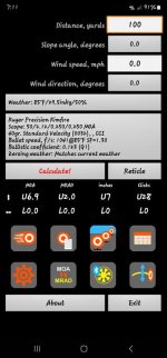

Thoroughly enjoying mine and the data. Sighted in a new Ruger precision rimfire yesterday using CCI std vel ammo at 50y. Took that data and entered it into my Strelok Pro app and I'm good to go for distance beyond 50y now. The Ruger, Vortex, and CCI ammo worked better than expected, especially the ammo.
