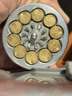

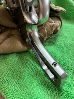

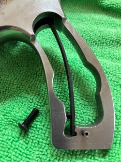

Bought a nice looking 617-10 4 inch revolver new over a yr ago and immediately found problems. Had the usual light strikes, spitting and I did not like the metallic sound of the action which I attributed to the hollow mim parts. My first thought was to try another mainspring and longer strain screw which made the trigger very bad but it was firing better. The longer strain screw caused the grip boss to be in the way so I had to trim the boss on both grips. I eventually decided to ditch the mim and replace with old K22 parts. I also experimented with a coil spring mainspring contraption. Kinda worked but this week I reassembled it back to almost original and started again. Kept the K22 hammer and trigger, long strain screw and standard flat mainspring. Replaced the firing pin and swapped out the cylinder lock with one with a better fit today. Fired 50 rds of federal over the last couple days with only 1 ftf but fired on a second hit. Since I swapped the cylinder bolt the lockup has zero movement, initially the cylinder had play which might have been causing the spitting I was experiencing. The new bolt seems to have eliminated the spitting. Thought that it needed forcing cone work but now maybe not. I did have a setback when the small hand torsion spring broke a leg. While the trigger pull is smooth those serrations on the trigger are not so I ordered a smooth wider target trigger via fleabay. I really like this Smith and think I’ve debugged it. I love his big brother.

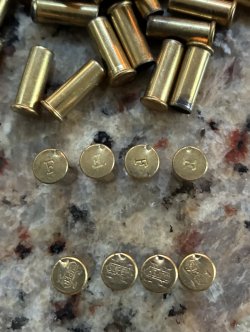

Tried something with my old fp [original to the revolver] today. I stoned a bevel on the top of the fp so that only the bottom 2/3 of it are striking the case. No energy is being wasted on hitting the fold of the case. Prior to modding the fp I fired 20 rds with one ftf, afterwards I fired 30 with no ftf. Top row was with the flattened fp while the lower four are with the modded fp. Still waiting for my target trigger. IMG_1093.jpeg

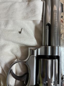

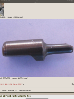

The crosspin doesn’t drive out as it just sits in a blind hole under the top of the sideplate, the fp spring keeps tension on it. Lost the first one. Theres a small spring in there too. The only tricky part is the sideplate. After removing the screws do not pry on it, just rap the grip frame with the nonmarring handle of your screwdriver and it will pop off. This is an image that the op of the thread I found posted. I didn’t remove that much material from my pin. He also removed the rear boss on his pin. I don’t think it would be necessary to do that either. IMG_1142.png
I know how to disassemble the gun, the question is how does the fp come out. It's not the same as a center fire
Push in slightly on the fp, remove the crosspin with a set of forceps and the pin will fall out. Then fish out the spring.

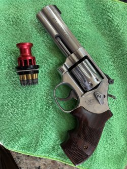

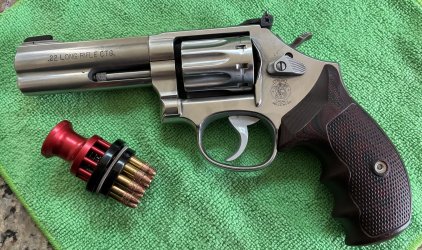

Finally got the smooth target trigger that I ordered 2 darn weeks ago. Was a snug fit but it went right into the frame. Engaged the hammer and cylinder lock perfectly. Very smooth. What a nice difference. No more sore trigger finger. Just put 60 rds through it. In swapping out the mim hammer/ trigger for a non-mim .22 hammer I have been shooting it without the hammer block relying in the rebound slide safety bump as the hammer wont work with the hammer block. Undecided if I want to modify the rf hammer, there is no cutout for the paddle of the block to fit in. As big a chunk of steel as the rebound slide is and as heavy as the rebound spring is they are not going to fail. I also removed the hammer lock internals a long time ago. Currently wearing the VZ grips from my 625 on it. A little proud in the horns. Liking the feel and the look. Called VZ about those grips in re/black and they don’t have them with no plans to make more. IMG_1103.jpegIMG_1105.jpeg
fwiw, the early 617s (-2) are different. the firing pin is different and does not come out that way.
Didn’t know that, thx Rich. Hopefully I will shoot it some tomorrow and compare it to my Colt Trooper MkIII.

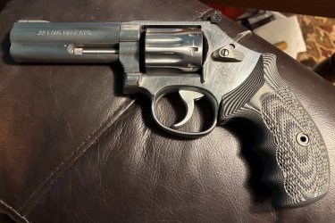

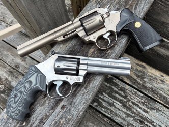

Just put 90 rds through it with two ftf’s, both winchester M22 but they went off on the second hit. Built a better strain screw out of a Lowes 8x32 allen screw. Couldn’t find a long enough set screw so I turned the head down using my drill press. Uses the same allen wrench as the VZ grips.IMG_1108.jpegIMG_1106.jpeg
Got my MkIII out and wow I had forgotten how heavy the mainspring was in this Colt. But it still rings steel. Need to set up my shooting table and cardboard but the rain is here. I do prefer 10 rds over 6 rds.IMG_1110.jpeg
