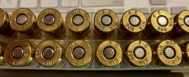

Anyone have any idea what the head stamp on the Federal GMM is? Sometime back I bought 500 allegedly once fired GMM .308s, headstamp is just FEDERAL and .308. Given the weight variation between cases, and the case length, I'm starting to wonder. LC Match brass has much better uniformity.

Still have 3 100 rd boxes of FedGMM, and it is all headstamped
F C 308 WIN
