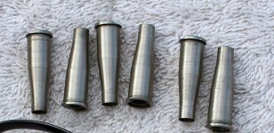

A question along the same lines. My gun K474264 has the correct numbered 22 LR cylinder that came with it but it was missing the Jet cylinder so I found a nice one eBay but it is not numbered. Were the original Jet cylinders numbered to the gun?
I have been watching those on several online auction sites. They come in the S&W box with space (a cut out in the cardboard) for the extra cylinder but the extra cylinder does not come with every revolver. Inserts do.
