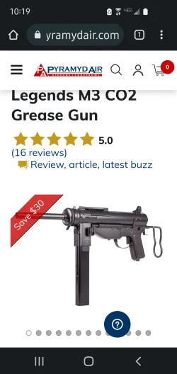

wow... did not think it would be an ACTUAL grease gun... I was ready for something completely different.. lol
