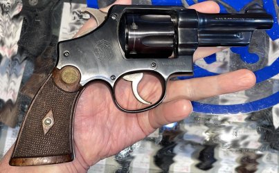

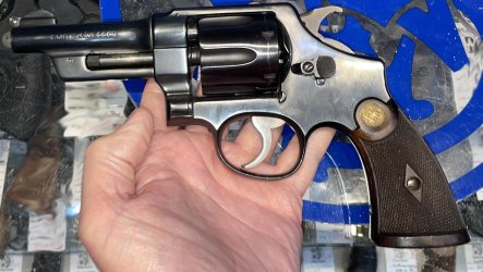

Hi,
I was hoping someone could tell me what to look for when a revolver has been reblued. I've only been collecting vintage S&W revolvers 3-4 years.
I have a chance to purchase this revolver once owner decides what to price it at. It hasn't been put on the market yet. When I first saw it I thought it was a 38/44.
I just wanted the knowledge in advance to help determine if the collectability is no longer if it has been reblued / refinished.
What little I know the side plate joints should be a smooth line that you hardly notice. There are voids on where side plate meets the frame in places. Plus I have read to inspect the screw holes being dished out.
Those areas to me look suspicious. The S/N is 58xxx so I think that's 1939-1940 vintage but the grips (relying on what I have learned appear to be earlier from 1911 to 1920.
The barrel length is 4 inches.
Sorry for the poor pictures. IT was a quick look and see since it wasn't for sale yet or I would have taken better pics. Just curious on rebluing and what this would be worth in this shape.
Also you can really see the swirl marks on the right side plate.
Thanks for your help.

Is that a hump back hammer? I've been looking for one of these.
Looks re-blued to me too. Also looks like a hump back hammer, would be a good shooter at the right price.
I wonder since it’s been re-blued if an $800 price would be fair. I have a few 38/44s and never thought about a 44 special but found it without really looking. I just didn’t want to pay too much collector value wise. If I remember the bore and rifling was good. Oh. I don’t have pics but it was a police revolver. There were stamps on the butt and was told it was some PD.
Yes it has the wrong (although still valuable) stocks. That style (deep dish large gold tone medallions) was used from about 1910 until just after WW1. Yours being 1939-40, it would have shipped with flush mounted large silver medallion stocks (grips).
Yes, I like that grip style and knew I could find the period correct for late 30s and use the service grips on another revolver.
I also have noticed 1937 -38 and earlier the small S&W logo was on the left side. Now it's larger and on the right side. I don't know if that is throughout the N Frame series of other models if the logo location follows that same pattern.
Hopefully once they run the check to be sure it's not stolen and price it I will be the new owner. I was looking in the latest 5th edition on values and I think this may fall into the $1200 price range. I thought the re-blueing hurt the value more. Still learning.

It looks reblued. If it was reblued at the S&W factory there is a stamp on the grip frame usually on the bottom left side. It is in a small rectangular box with the letters R-B in it. The stamping is fairly light. I brought my Model 1926 to the factory for refinishing and this is the way they marked them fifty years ago.

Get a serial number and lets see what range it falls in.
I call re-blue, but not a bad one.
The humpback hammer is special order, so the gun might have gone someplace interesting.
