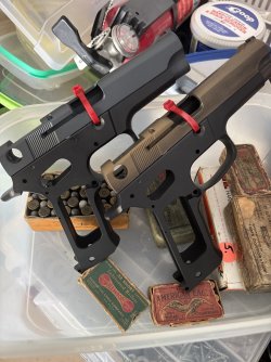

Hi everyone, I’m brand new to the forum and to S&W pistols in general. I picked these up at a garage sale yesterday not really knowing what I was getting into. A quick search online found that 5906 parts kits are going to be difficult to find. Over at Sigforum, a member told me that 519 parts will fit and will be easier to source than 5906.
My question now is the rear sights…the cutout is huge. Is this for the large adjustable factory sight?
Any help with this project will be appreciated, as I’m sure it’s been discussed before!

Also, the referenced pistol is not a 519, he probably said or meant to say 915. However, the fact is that there are a large number of models that share parts with the 5906. Almost too numerous to list. Or rather... I could list a bunch, but there are some that I will have forgotten. And some models have some parts you can use, other models have different parts you can use.
When I look at what you show in the picture, my knee jerk reaction is that the best plan is NOT to gather parts and build two guns, but instead... find someone who needs what you have and sell these parts to them.
915 and 5904 parts kits will get you most of the internals. Wide hood barrels and adjustable sights will be a little more challenging to source.

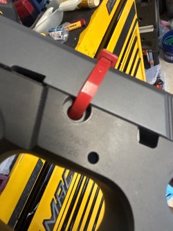

Those look like 5904 frames.
I have all the parts to make a complete pistol, just need a frame. Just saying:)
Check out Everygunparts.com . They have kits , don't know if they have what you need . Your's is a pretty common , so you might be able to find one or two .
915 parts will fit although the magazine catch is different. Also many other 3rd Gen parts will fit. 69xx parts will fit, including the Drawbar. The adjustable sight assembly could take some searching and I wonder if a Red Dot sight would fit.

I think you may be confusing the 915/411 with the true Value Line 3-digit model number 3rd Gens like the 908, 909, 910 and 410.
The 915/411 is nearly the same as the 5904 and 4004 except the frame is not stepped, the rear sight is not Novak, single sided decocker and low-dollar matte finish.
The 908, 909, 910 and 410 had the plastic bits like the mag catch, guide rod... one other plastic part I cannot recall.
So I believe the 915 mag catch and the 5906 mag catch are the same except for finish color.

Disconnector, I think is the other plastic part you’re thinking of.
Mag catch is the same for the 915,5904/5906
You don't happen to live in NorthEast TX. do you ? You bring lunch and I would be glad to put those together for you. Not sure about the wide hood barrels, I know I have a bunch of narrow hood ones I think. I will poke around tomorrow and see whats in the shop. I would hold off buying complete kits for a bit until you figure out exactly what you have and need.
