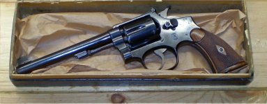

Welcome, you might consider purchasing another set of stocks that fit the 1920s decade to have an era-correct S&W. I have a similar era gun, a 38 Target 482353 era gun with correct stocks, pictured below. These stocks can be picked up often on ebay. You could also put a WTB ad on this Forum - https://smith-wessonforum.com/wanted-buy/. Those with some wear will usually be affordable and appropriate for your revolver.
