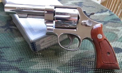

Been reading a lot and slowly acquiring some Smith pistols, and just bought a model 58 and it has what I believe are target grips. I can't upload pictures because the pistol is in the WA state 10 day jail requirement. With the research I have done the pistol should have been shipped with Magna grips and just want to verify exactly what I a need to look for to get the correct era grips for the pistol. From my research the Model 58 and Model 520 sported the same grips. I do have a 520 Pic attached, just want to verify that these are what I need to be on the lookout for. This is not an S serial number gun, it is a N serial number gun.

The main thing to be mindful of is Model 58 magnas have that rounded edge at the base rather the straight edge with a sharp outside corner.
It is easy to find the straight edge ones, but not seeing the rounded ones. No rush I will keep looking.
That's exactly what you are looking for. If your gun is pre 1968 you would want the diamond around the grip screw. The diamonds are hard to find and expensive. Good luck.
looking at the page that has dates by SN's on a sticky it is post 68. N271XXX places it in the 75-77 range. So that makes it a little easier to find some I hope.
Man that is nice! I'd love to add a nickel 58 to my collection. All I have is a paltry blue 58!
Several years ago I bought a pristine, blue pre68 M 58 from an FFL buddy. He said, well if you like that...and he pulled the nickel with original box from under his table. I bought both. I kike to use this picture of an unfired outside the factory cylinder.IMG_0389 (2).webp
