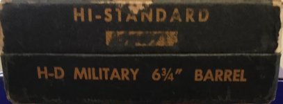

A Friend is seeking info and value on a High Standard Hd Military. It has been In family since 1959.
Serial number 146256-
Pictures are best she could do right now. Gun much better shape than pictures show. Box is in good shape and has no end label like the smiths do.
Any HS experts here? Any and all info is appreciated!

Just sold nice one 1st of year for $600. That close to top money unless NIB. Op gun aftermarket grips.
Sounds about right. I’d would have said $500 to $600 range would be reasonable asking retail price. Trade in offer to a LGS will probably start in $3xx range.
Yep, keep those recoil springs fresh and stick to SV.
I have several Hi Standard pistols made from 1941 to 1973. I have shot tens of thousands rounds through most and haven’t had a frame crack yet.
The HD Military that you’ve shown was made in 1946, the first year. I have had a 1947 one for over 30 years and still like it. It’s in really good shape but probably still only worth the $450.00 I paid for it back then.
Prices have been @ $450.00 - $600.00 for just a great condition HD, a bit more for box and extra magazines and such. Military marked ones go for a few more.
When I got mine the seller said the box wasn’t original and that “someone” had scratched off the original serial number.
I’ve a question for you. Does that Military Grip magazine work in the HD?. I only have and use the standard ones for mine.

Thank you to everyone who is pitching in with info-
And thanks Jim for your info. I will ask her if she fired it with that magazine tomorrow. I am curious myself if the magazine pictured *IN* the gun is the one also pictured in the plastic bag.
She relayed to me that there were NO markings on the box, but I will double check that also.
That mag pictured will not work in HD Mil. I’ve had one for over 50yrs and had bought several wrong mags before I got some smarts. Have had no luck with aftermarket mags. If you buy wrong HS mag at least you can sell and break even.

I’m not familiar with that box, but I’m no expert on HS either. I love the grips!
Here’s my HD Military. As you can see from the photos, the box is black and does have an end label. I wouldn’t part with mine for $600.
