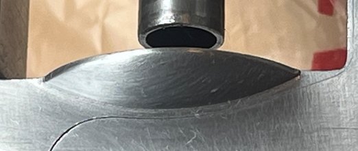

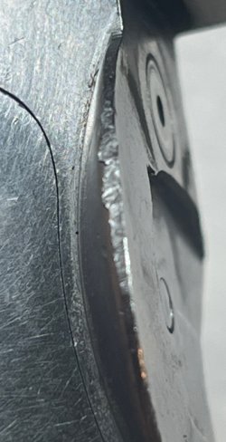

First, a nice big set of divots left in the barrel by the destruction company that provided the model 65 parts kit:

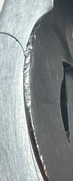

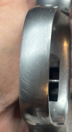

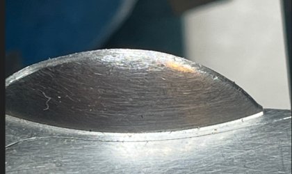

Second, there was some road rash on the edge of the recoil shield:

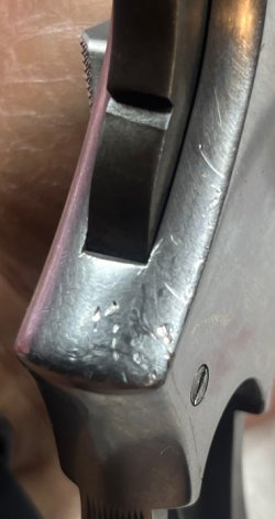

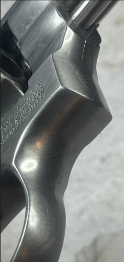

And finally there was this lovely pattern right above the grip frame and behind the hammer.
If someone can tell me the proper term for this area I'd appreciate it....
The barrel divots turned out to be very easy and were a textbook exercise in drawfiling that took less than 5 minutes to remove. In this picture the file marks have not been cleaned up yet.
To my surprise, the recoil shield wasn't that hard to clean up either. It just took patience and following the lines of the intact portions....
Here's part way through, still with some shaping and a couple of marks to remove:
And here's how it ended up:

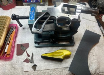

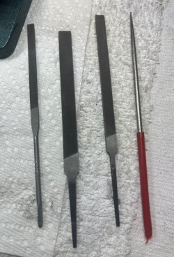

So far, these are the only tools that were used (along with a file card that isn't in the picture):

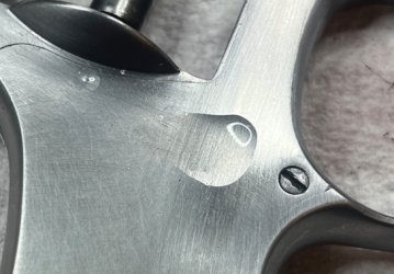

We left off with the next step being to address the area behind the hammer that had been used as a hammer....or more likely dropped in a bunch of rocks.
With the gun held in a benchtop vise, a #2 file was used to start reducing the area around the dimples. Being ambidextrous really helped here because I was able to follow the curve of the frame from right to left and then switch hands and repeat the motion from left to right without moving the work. The small dimples went away quickly, leaving only the big dents to be worked on slowly.
My mindset during this work was not to remove the dents. I made my goal to reduce the height of the frame and keep the edges straight....the dents would come out all on their own.
Getting there. Still doing the rocking motion and reversing the direction between strokes to keep it even and not drop one side more than the other.
Every once in a while I would lay the file flat on the side of the frame and make a swipe or two along the side just to keep the edge line intact. The dimples along the corner went away without me really noticing or I would have grabbed an "almost there" picture.
...and finally the big dent in the middle went away. I've found that it's necessary to take 3 or 4 additional strokes after the dent seems to be gone because a little speck of a dimple always seems to show up during finishing after hiding inside a file cut and not really showing until the surrounding surface is smoothed out.

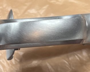

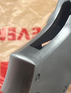

The last bit of work here was very finicky: restoring the edge at the top of the backstrap and blending the area that had been worked with the up-sweep of the frame on each side of the hammer. For this I switched from the #2 Nicholson file to a #6 Swiss pattern file from Grobet. The set of Grobet files cost $130, but they are worth every penny.
This picture is from when I started working on the back edge. Unfortunately I didn't get a picture of the area before moving on to finishing, so you'll just have to wait to see how it turned out. :devilish:

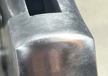

Some scraps of 220 and 320 grit sandpaper were used to blend the file marks into a cross-hatch pattern. Here's a shot of the work area at the end of the sanding....

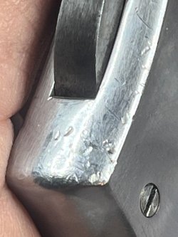

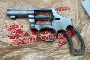

There were far too many dents, dings, divots, and dimples around the trigger guard and the area of the frame below the yoke for me to put up with, and they were too deep for the Scotch-Brite to correct by itself.....or at least not in the time I have left on this mortal coil.
Several projects ago I learned the hard way to never ever leave abrasives or cutting tools in the work area while I was trying to do something else, so all the Scotch-Brite and sandpaper was completely put away and the work area was set up for file work again.
File, file, file, sandpaper, file, sandpaper and we were ready to start with the Scotch-Brite again.
Since I was going to be sanding wet, I spread a plastic shopping bag out flat on the workbench so that gritty liquid wouldn't be absorbed into the towel and spread to other projects.

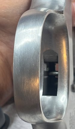

As I said before, the method I used with the Scotch-Brite was not gentle. I scrubbed that sucker like I was a dishwasher with a health department inspector standing in the doorway. Some of the scrubbing was done with just the pad, other parts were done using a pad holder.
I'm running out of ways to describe scrubbing, so here are a bunch of pictures taken during the process:

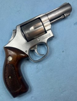

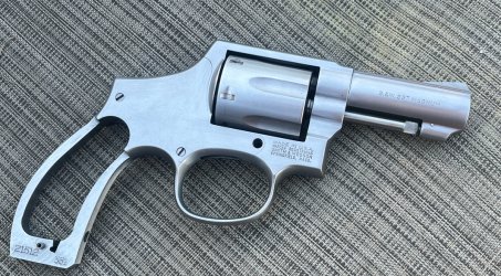

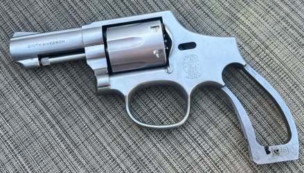

When I thought I had scrubbed enough, I wiped off all the residue, cleaned the entire exterior with Hoppe's, and went outside to get a couple of pictures in natural light.
I liked the way it looked, so all the various pieces were moved from the outside to the inside, and a set of stocks was put on for the trademark HomeSmith blue shop towel picture:
With this gun I only used the maroon pads #7447. When I work on the next one, I'll do a pass with 7447 and then repeat the process with the next step finer, the grey #7445 pads. I'm not sure when that will be, but I'll post about it when the time comes.

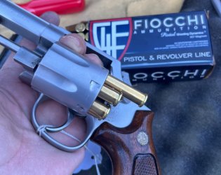

Short and Shiny made another range trip today because there was something I wanted to verify: factory "hard primer" magnum ammo. I shot S&S last time with my magnum reloads and they worked fine, but those use Federal primers. S&S has a 7lb double action pull and 48 ounces of hammer tension so it should be ok.
If anything would give it trouble, it would be these:
BangBangBangBangBangBang
No problems at all. Nice hard primer hits and the empties fell out with no issues.
The real bonus was at the target. This would make excellent carry ammo for this gun...powerful and hits to the same point of impact as 158 grain .38 special lead semi-wadcutters.

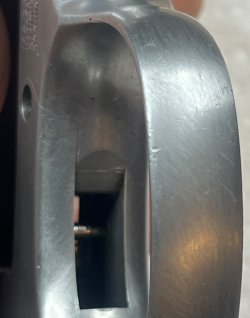

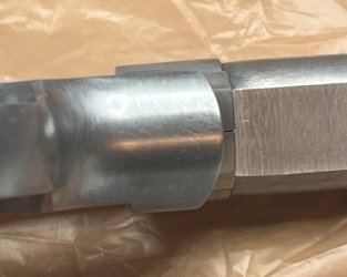

When I got home and was wiping everything off to be put away, I discovered an ugly portion of the cylinder that I missed earlier. Reason number 87 that I like working with stainless steel is that it took 15 minutes to fix this instead of a week of rebluing.
A #2 Nicholson file got it this far.....
Then the #6 Grobet file, some 220 sandpaper, some 320 sandpaper, and a quick scrub with the 7447 Scotch-Brite produced this:
