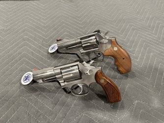

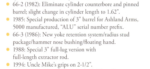

While looking through the new 5th edition of the Standard Catalog, I see a mention of a 3" model 66-3 that they refer to as a 1988 Special, if I am reading that correctly. I have this one pictured here with the box and tools that I bought used several years ago to complete my Model 66 collection.
I am wondering how many of these were made, if anyone knows. I guess it may be time to request a letter.

Can’t help you, but I have the same revolver, minus the box.
Might be the last gun I would ever sell.
I really like the sight ramp aesthetics on these as opposed to the more abrupt ramp on other 3”s.
I’ve heard somewhere in the 275-500 range but that could be completely made up as I don’t have any actual info backing that number up. They seem to surface less often that the 66-2 3”ers.

IIRC the reporting is that about 5000 -2s were built for Ashland Supply
