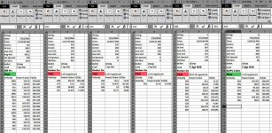

I have been working up a 125xtp load for my 642 2in. using HS6 powder. I have been using my 4in 686 as my load testing gun. I thought I was doing just fine, that is until I tried to chronograph this 125xtp 38+P load in my little 642 snubby.
I know/understand that nearly all reloading books use long barrels in order to maximize FPM. Personally, I do not know of any "Snubby Reloading Manuals" (please post me a link if such exists).
I have attached a screen shot of five strings I ran this morning using my 38 workup loads, both 38 and 38+P. The first four strings are of 38+P loads and the last two are my standard 38 load. Both are for 125xtp bullets.
I thought the results were a fluke, as I had had similar problems recording/chronographing 125xtp yesterday as well. Thought maybe I didn't get the chrono set up properly (too much sun, fluorescent lamps, etc) , so today I set up the chrono with the powered diffuser light, turned of my overhead Fl tubes, and made sure the chrono was further into the shop and away from the sun's glare.
I still got a big :eek:FAIL:eek: when trying to test these loads on my 2in snubby. When using my 4in 686 and my 2.62in 627PC, I got solid numbers.
Please take a look below, and share your thoughts... :)

Have you experimented with the distance you have your screens set at? With a snub nose gun, that could make a difference.

I guessing that a 2" barrel with light bullets doesn't allow enough time for full pressure to develop so all the powder doesn't ignite. Any powder left in the cases or elsewhere? In essence, the powder is too slow.
You are getting interference from unburned powder crossing the chrono. If you back off another yard or so it might clear up. I have had the same thing happen with me before; it gave way abnormally low numbers. Moving my chrono out another yard or so stopped the interference in my case.
I think Muddocktor is on the right track with his suggestion above. If some of the OP's loads were in the 200 ft/sec range they would have less recoil than a .22 LR round, which the OP didn't mention. Also, the Speer manual has data for 2 inch barrel .38 Special and +P loads, some of them using VV 3N37, which is a slower powder than HS6. Generally the fastest loads in snubbies are the same as the fastest loads in longer barreled guns (with lower velocity, of course).
I actually did back off to about 3-1/2 to 4yd from the chrono, just to see if that was a/the problem. Not clear, but string #5 results may be indicative of such interference. Four of the ten shots were <200fps while the other six shots much higher, with Hi=907fps. Plus, the very first shot in string #2 registered at 978fps! So... maybe... :confused:
As far as un-burnt powder on the concrete floor, I didn't really see any, after sweeping and collecting in a dustpan. What I did find was plenty of very fine burnt greenish-black powder remnants. The sound of ALL rounds going off seemed to be the same to me (w/earmuffs).

OK, the standard distance for chronograph work is 15 feet, muzzle to center of the screens. Closer than that, you run the risk of the muzzle blast/particulates triggering the start of timing.
You're also having problems with your basic setup. Most instructions for skyscreens/optical sensors specify NOT to use fluorescent lights. The flickering of the lights can throw the sensors off. The best way to clock loads is in bright sunlight with the use of diffusers. It's also a good idea to check your setup with .22 lr. before testing. Velocities from a rifle should run 1100-1200 f/s.

My best guess is you have chrono issues

Nothing wrong with the gun. Nothing is wrong with the powder. The problem is the chronograph as others have suggested.
If you were getting velocities that low you'd have had stuck bullets in the barrel. Once you go under the 500 FPS range you start to run into problems.

OK.......... I finally got some results that I can believe, not necessarily great results but OK.
Personally, IMO, it was the highly reflective overhead door (in background of image) that was throwing off the chrono. Sure, 15ft is better than the 5-10ft (recommended from the owner's manual), but truly think the former is more likely than the latter. After all, both the 686 and 627PC did well at the shorter gun/chrono distances, and WITHOUT any chrono cover/shield.
Bottom line is that I thought I would get better FPS results at 7.7gr of HS6 with the 2in. LEE goes to 7.8gr of HS6 and Hornady goes as high as 8.1grains. I probably will NOT go that high because with this light load I get a lot of powder residue/buildup. There has to be a cleaner alternative.
