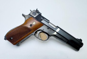

I am now the proud owner of a S&W 52 (s)
