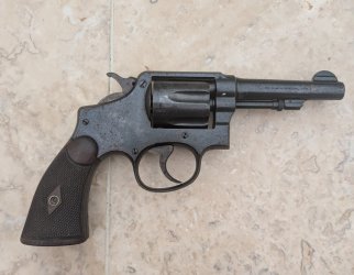

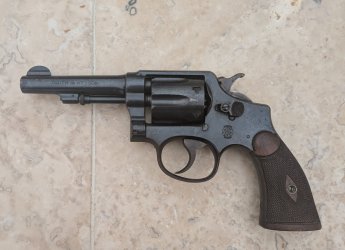

Could anyone help me identify an inherited S&W K38? Serial number on grip bottom is 390728, on the yoke is 11576.
Thanks
On the other hand, if it's simply a K-frame Military & Police with the non-prefixed serial number 390728, it'd have most likely shipped in 1922. We really need a picture or two here, including of that number on the butt.
Sniggins
That number (390278) is on the butt, not the yoke. The number on the yoke is irrelevant.
As Goony stated, you have a .38 Military & Police revolver that probably shipped in 1922, perhaps a year earlier. The absence of Made in U.S.A. on the frame indicates production was prior to about mid-year 1922.
