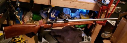

Looking at an interesting 22-250 bench rest rifle built on a Interarms Whitworth Mauser action, in doing some research I see large caliber models but nothing small like this one.
Can anyone shed some info on this?
Also, is a visual inspection of the chamber/bore good enough to determine it's condition?
Thanks in advance.....

Some additional info, the current owner has shot 20 rounds thru it, says it shoots sub moa @100 yards, he bought it from the son of the original owner who had it built, and allegedly spent its life in his safe.
He is asking $550 for it.
I appreciate all the info given thus far.

The photos show the bolt closed so we can't tell if it is a single shot or multi shot (3 to 5). If it has been set up for single shot, some modification should have done to the extractor. Most BR guns and some custom Varminters, don't have ejectors! Not a real problem, you just lift off the fired case instead of look for it later!
I'd buy the gun "as is" for varmint, But go over the trigger mechanism with a "fine tooth comb" cleaning and lubing! (The worst thing about the factory guns was loose grit in the mechanicals of the trigger!)
I personally prefer other rounds to 22-250, but it will definitely get the job done for varmints and this might be a good beginner BR gun. Since your bolt face is already the Mauser size I'd rebarrel it in 6 BR 1:7 twist and use 105-107 VLD bullets. That will be good for 1000 yards if you want.
Lastly, That is a fine looking gun, very similar lines to the Cooper Montana Varminter. Put a 6.5-20x 50mm Leupold with a Target Dot recital on it and you won't be embarrassed, that's for sure!

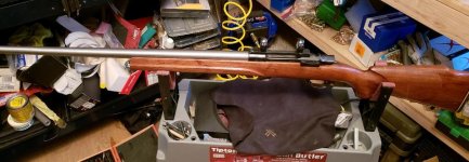

Follow up to this thread, after seeing the gun in person we worked out a good trade deal. It took a few trips to the range but yesterday I found a load that it likes, 52gr Hornady BTHP, 36.0 gr Win 748, 2.350" COL, no crimp.
This is 3 shots @ 100 yards.
I stripped and refinished the stock as it had a stain from what I suspect is cleaning fluid spilled on it so it looks as good as it shoots.
Thanks again for all the knowledge shared.

I'm going to disagree with Ivan when it comes to the original factory triggers on the Zastava built Whitworths, Mark X, etc., Mauser 98 rifles. The factory trigger is a very nice adjustable trigger. It can be adjusted to a light, crisp, creep free ,clean breaking trigger.
Looking at the photos I looks like it may have the original trigger.
