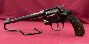

It's designed to help keep the cylinder in the gun on firing. Yes Colt doesn't have one because the cylinder release in the Colt mechanically blocks the cylinder from coming out. Tighten it if there is a problem or even shorten it a little.
This thread had me thinking. The cylinder release / locking in the Colt is a different design than the S&W with the Colt "locking pin" being larger and mounted in the frame. The S&W smaller and mounted in the cylinder. Pictures are of a 1956 Colt Official Police and a 1974 SW Model 15. Pull back on the Colt, push forward on the Smith to release cylinder. Don't know if using proper terminology.
