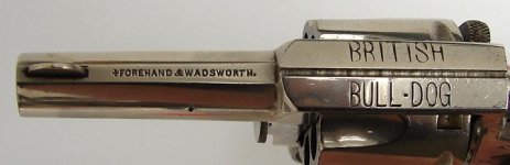

I was in a pawn shop today was about to leave when I found out that the guy had a "junk box". There was the usual assortment of junk as the name indicates. But, I also saw this:
The topstrap is marked "British Bulldog" and it appears to be approximately .44 caliber. I know many companies in Europe (primarily Belgium) as well as stateside made copies of this Webley design.

The extractor looks like a Nagant type, not something that Webley may have made. If possible, look for Belgian proofs on it.

I suspect it's Belgian also. I just figured it was interesting enough to display w/ my Sherlock Holmes memorabilia.... at the right price. :)

I'm guessing Belgian but worse the finish looks like it was in a fire.
It's a (US made) Forehand & Wadsworth.
The F&W trademark of a bulldog head with TRADE above and MARK below is stamped on the left side of the frame where the bbl screws in. Hard to see but it's there especially if you enlarge the pic.
While I suspect that it is a Belgian knockoff, in that condition I doubt it makes much difference who made it. It would make a nice curio if cheap enough. I remember that in times past, one like that might sell for $5 at a gun show. I remember seeing tables full of them.
According to Charles, it says "British Bulldog" on the top strap, which matches the F & W's I've seen. However, all had "Forehand & Wadsworth" stamped on the top flat of the barrel, which I think he would have mentioned.

Well, here's a pic of a F&W Bulldog with theie trademark/dog head logo in the same position. I probably mis-spoke calling the caricature a Bull-Dog,,could be Husky!
Look at the OP's pic of the faint marking in the same loc on his revolver and move the cursor over the pic in the link to enlarge it and I think you can easily see the same mark.
But maybe some Belgian maker copied the famous F&W trademark too. Look for Belgian proofs I guess.
F&W was bought out by Hopkins & Allen and H&A continued to assemble from parts and then produce some of F&W designs.
H&A had already been producing most of F&W handguns for them near the end of F&W's mfg/factory around 1900+.
Just what I see.
Forehand and Wadsworth Indian Bull-Dog DA revolver with dog head trade mark on top left side of fr
