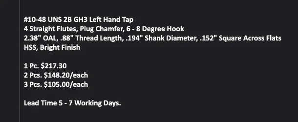

For those wondering what LH 10-48 tap costs these days.
From Cheboygan, MI tooling.
