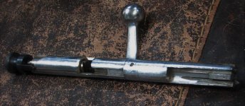

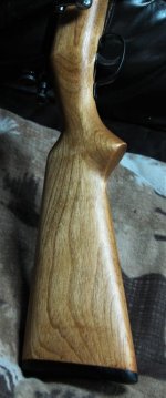

Picked it up earlier today 80.00 OTD.........it's an early 30's bolt action tube fed .22. I have a weakness for 22's and like fixing them up.
So far so good. Really liked the bolt and peep sights.

Then they had the A version of the action where the bolt handle locked against the rear of the ejection port.
The 'B' style action, like here, locks further back in the rec'vr from the port. I think these were also named 'Buckhorn' series rifles.
Then it all gets pretty foggy trying to separate them from there on out...!
Nice little rifle! Great price IMO. They'll plunk bullseyes all day long for you.
Looks like the pre-WW2 version as the safety is on the bolt head,,pull it back and turn it CW to set the striker on the edge of the rec'v. (same as the Mosin Nagant).
Post war added a thumb safety on the right side/rear of the rec'vr. Trigger guards were steel pre-war. Went to aluminum or a zinc casting & plastic after the War but probably some changeover period to use up old parts exists. They didn't throw nuthin' away.
