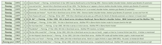

It's incredible just how much scrutiny the Bond books require, to be clear on how the original Fleming titles inventory his pistols and gunleather.
Using a set of PDFs of all 13 of his original titles I was able to zero in on what he actually says there vs. what perhaps I thought he did :-).
bond book series holsters.jpg This is hardly legible for you, dunno why, it's rather a large image.
So: essentially, from the 1st title that was Casino Royale: Chamois leather shoulder holster, skeleton grip Beretta 25 automatic. It remains this combo until From Russia With Love at which point Fleming has committed to Boothroyd that he will create a problem with Bond's Beretta to enable a change in the next book; curiously there is no holster involved in this mishap, with Bond instead entangling his silenced pistol inside his waistband.
The book series is infamous for Fleming's Dr. No title pairing the Walther PPK with a Berns-Martin shoulder holster that wasn't made for automatics. And yes, from the letters between Fleming and Boothroyd we are clear that Boothroyd meant the Centennial and the Berns-Martin for Bond and the Walther PPK for Bond's post-war European enemies.
Immediately realizing his mistake Fleming corrected his error in all the books that appeared after Dr. No.'s intro of the PPK in 1958: the holster usually stayed a Berns-Martin but was not ever a shoulder holster again: it became a waistband holster. But so subtle was the changeover that it was only over the last year or so that I realized how Fleming had solved 'the problem with Berns-Martin' by simply -- changing its 'style'.
