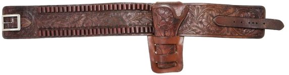

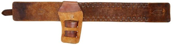

And the front and backside of a magnificent Scout belt by Heiser; which they officially called a Money belt:
sets (3)a.jpg Whoops, NOT a scout belt; notice that the stitching of the loops is showing on the backside; so it is a single layer of leather in this case.
