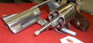

JUST bought this 696-1 3 inch .44 spl
Avery11
Dec 5, 2010
712
406
Location Location
I bought this on a bit of instinct and from what I understand, just in the nick of time - another potential buyer was trying to haggle.
I called up and said "I'll take it" for $675 shipped.
Anything I should know about this neat little L frame?
Owner testimonials?
Not sure how I did on the price as I have not even taken the time to do any real research which is uncharacteristic of me. I've never seen one of these until now and something just told me I'd regret it if I let it pass. Should be a nice little woods gun for the east coast.
The owner said it is from an estate. The late owner rarely shot his guns and I'm told this one is like new.
Here is the dealer photo:
