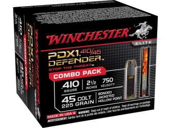

It was my Dad’s. He bought a box of those hybrid disc and shot loads. I took a few to the range and found their patterns to be rather goofy. The discs went low and left, the shot went high and right. Big hole in the middle. Makes sense “ballistically” - all of the projectiles department at the same velocity, but the discs have a different drag coefficient than the shot, so they fly different trajectories. Didn’t look real useful to me.
As such, I tested plain ol’ 00 buck and got decent groups out to 10 yards. So that is what I would load it with for more social work, if it came to that.
