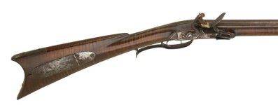

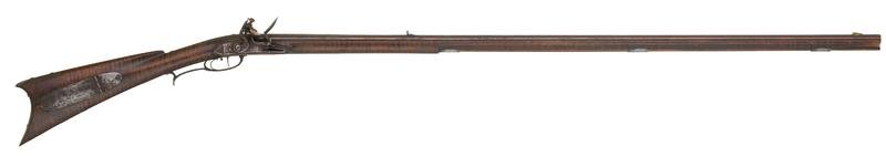

Fun! Those look great. If you ever get ambitious, you could get away with removing quite a bit more wood on those and have trimmer pistols, but of course that makes a much bigger project. I'm glad those are working well for you. I might get one of those sometime. How's the ignition on the flintlock? pretty fast and reliable?
I don't have any pistols, but use this for deer sometimes:
I'm seriously looking at getting one of Jim Kibler's new fowler kits.

That's a great looking flintlock rifle. I shouldered a Kentucky once, but the stock felt too short. Right now, i cant tell one from another. The ignition on my flintlock pistol is about 2 seconds and has been 100% reliable so far.
