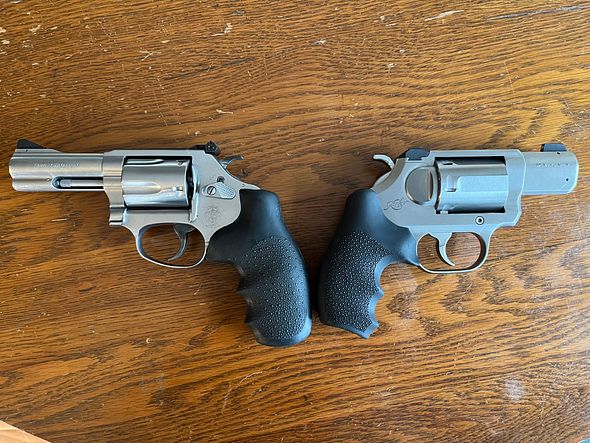

I found a Kimber K6S awhile back and I've formed some impressions, mostly positive.
I like the overall size of the revolver and it compares very favorably to the SP101 and the S&W Model 60.
It weighs in at 26.7 oz loaded, compared to an almost identical 27.2 oz for the 2.125" Model 60, and 29.5" for the 3" SP101.
Kimber has also figured out (unlike S&W or Ruger) that grips on J frame size .357s that place the middle finger behind the trigger guard are painful under recoil of full power .357 Magnum loads. The stock grip on the K6S keeps the middle finger down out of the way of the trigger guard.
The standard wood grips are reasonably comfortable with .38 Special, but the short boot grip design is a bit fierce with full power .357 Mag loads. It'll be getting a set of Hogue rubber grips for every day use.
The revolver is nicely dehorned on all the exterior edges and is very comfortable to carry IWB.
The width of the K6S is impressive as it's a 6 shot revolver but maintains the cylinder diameter of a 5 shot J frame.
It shoots to point of aim and it has a superbly smooth and light DA trigger out of the box and on the DASA, an exceptionally good SA trigger as well.
It also has real, full size sights that are a huge improvement over the usual small sights or gutter sights found on J frame sized revolvers and the rear sight is drift adjustable.
That advantage is lost on many shooters who associate snub nose revolvers as inaccurate "belly guns" not capable of significant accuracy. That's just not the case as most quality snub nose revolvers have excellent mechanical accuracy. The sights are also low snag so I'm just not seeing a downside.
The K6S uses a Ruger style press to release cylinder release that is easy for S&W "push forward to release" shooters to adapt to, unlike the Colt "pull to release" system.

I like your size-comparison photos, good job!

Small update to the thread.
I'm not a big advocate for making "upgrades" unless you've actually shot the firearm and found an actual reason.
The wood boot style grips on the K6S were a bit narrow and not all that comfortable with full power .357 Magnum loads, and since I plan to carry .357 Magnum loads as I do in my Model 60 and SP 101, I opted to order a pair of Hogue grips for it.
The grips are a bit different than the Hogue grips for the Model 60 and SP101. On those revolvers a little metal clip locks over the ends of the pin in the grip frame and is secured with screw at the bottom of the grip. With the K6S they provide a pair of end caps for the pin in the grip frame and the grip is then slide and rotated over the grip frame until the caps snap into recesses in the grip.
It's different but very secure. If you need to remove them they supply a two pronged tool with wedges that slide between grip and grip frame to lift the end caps out of the recesses.
The main advantage is that it keeps the grip length shorter than on a Model 60 or SP101.
In this case the grip adds about half a width for your little finger, enough for it to get a firm purchase on the grip without making it overly long. It's a very nice compromise adding control while not giving up in terms of compactness.
As an added bonus the profile of the Hogue grip does not interfere with the HKS DS model speed loader, so these less expensive speed loaders work just fine with the K6S/Hogue combination.
