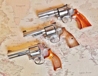

If the goal is to add an L-frame to your collection, there are many interesting ones aside from the ubiquitous 58X/68X series. Here are some from my collection...
Before the Model 69 came along there were four, 5-shot, L-frames in .44 Special
If it's a .357 Mag that you are after, here are some L-frame alternatives
If .38 Special is what trips your trigger, here are two - a 586-4 and a 686-6 That are chambered just for .38 Special
And the last uncommon one that I have is my 646, a six-shot, titanium cylinder, .40 S&W
