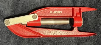

If I may offer a snippet of advice, if space is a primary concern you might also wish to take a look at the Lee “Breech Lock Hand Press.” While it isn’t as capable as a bench-mounted press, it is significantly more convenient (and far less noisy) than a Classic Lee Loader. A hand press, dies, and all associated support equipment fit nearly in a small tool box.

The Lee Hand Press is cheap and miles ahead the entry level Lee. Takes up about zero space too.

Hammers are loud.
Hand press is quiet.
Hand priming tool is wise.
Worth the investment.
Hand press will fit in saddle bags, Horse or Harley.

I have a Lee Hand Press and like it. I had a Lee Loader and hated it.
MY observation: The Lee Hand press (Lovingly called the "Nutcracker" by thousands of people that own them), The require far more dexterity to use than any other form of reloading (right up there with Lyman 310 tools!)

If you want to get into reloading look at a Lee Hand Press ...it's a nifty little hand held press , no bench required , I use one to reload all my Handgun ammo , from 32 acp to 45 acp and 38 Special to 45 Colt and 30-30 rifle ... I'm 75 and don't have extraordinary hand arm strength .
So it can't be hard ...I'm old .
The Lee Hand Press Kit , a set of reloading dies and a shell holder will let you make ammo sitting at your desk , kitchen or dining table or coffee table ... just about anywhere you have a flat surface ... and No Banging !
Lee Hand Press ...is ... Handy !
This x 10. And I have both.
