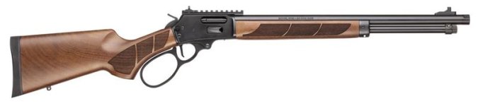

I think the S&W 1854 Walnut is also a good choice in the Marlin price range. If 44 Magnum is acceptable. It is already set up nice and has the quick empty magazine tube feature. The photo was borrowed from the S&W website.
