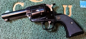

Is this for?? I bought a Colt M1909 U.S.Army in .45 Colt a few years ago. I read in an article that the War Department's required load for these was a 250 grain bullet at 750 FPS. I figured that was good enough for me as that was the combat loading at the time. A friend worked up about 20 different loadings to equal that War Department requirement. I used 5.6 grains of Bullseye with a 2450 cast RN bullet. I used it in my 1909 and my S&W 25. It will be used in my Vaquero when I take it to the range. If it was a good enough loading for the military to poke holes in their opponents, then I can punch paper and whatever with it.
