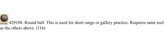

I've heard people having good luck loading 32S&W Shorts and Longs with .315" or .320"round ball / #0 buckshot, and 38 specials with #000 (.360") buckshot. Shame there's no .433" buckshot equivalent for cheap soft lead plinking ammo!
429 ball mold
Ideal/Lyman made a Single cavity .429 iron ball mold in 108grain. Or custom ordered Double and even 4 cavity gang molds in .429 ball. The old molds show up on Ebay now and again. If you can find one Smith and Wesson made a Peanut mold in 44 Russian that has a conical and ball mold. "Good luck"... There are always custom molds that can be made at a relatively cheap price if done in an aluminum mold for under $50 from various custom mold makers. So you actually have a lot of options.
