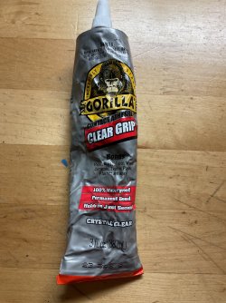

I have used this Gorilla Clear Grip Adhesive on all sorts of things for years. Great bond for all materials. Just recently bonded the soles back on my wading boots where they were coming loose. Walmart has it.
