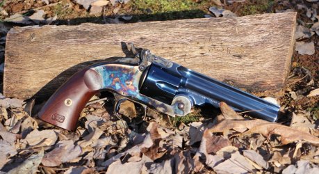

I had new Taylors Scofield that the trigger pin kept walking out. Probably could have bent it slightly and been fine, Taylors said to send it in. Figured they would do the same thing and mess up the fire blue. Carefully used green Loctite on both sides of the pin and solved the problem without damaging the chemical color case finish or the fire blue. $999.95.jpg
