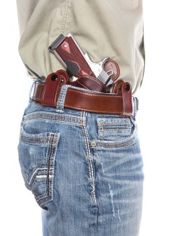

When I’m not pocket carrying, I carry IWB.
Leather is the most comfortable.
Above is an example. I prefer this design over all else. The weight is distributed over a wider area unlike the one pictured below.

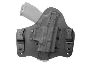

With the belt loops on top, it adds outward bulk which defeats the purpose.
Another option is a hybrid shown below.
I’ve gone through many holsters and have a drawer full. But I always choose my leather. I’ve had it for close to 25 years. Still going strong.
You do not need retention.
Note the hammer/slide shield. It’s a must.

I REALLY like the look of the top holster Thank you for sharing your info and the great pictures.

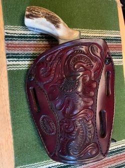

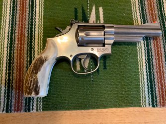

Can confirm on Lobo, my 4” k frame pancake is magnificent. It’s wide enough to spread the weight, light and stiff enough to support the revolver and comfy.
