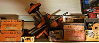

This is a TruLine Jr. Press. It uses 310 Tool dies also. In boxes pictured with it are dies for 250 Savage, 300 Savage, 222 Remington and .257 Roberts.
