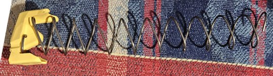

Mine was bought new in March of 2022, and I got two additional magazines a month or so later.
Mine were never too hard to load using just my fingers.
I took all four of them apart a little while ago, here's a picture of the spring in one of them.
I ALSO measured the spring wire thickness and got 0.0515".
Could you, OR ANYBODY READING THIS WHO HAS A RECENTLY PURCHASED MAGAZINE, pop your magazine open and see if the spring looks the same, AND measure the spring wire thickness?
This way I can see if they're any different today than they were in the early days.
A BIG THANK YOU TO ANYBODY WHO CAN HELP ME WITH THIS.
