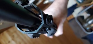

So rather than trust my handguard to hold up over the long haul, I purchased a Areo Precision Atlas S-1.
If you notice the ribs inside the tube, they extend the entire length, so no matter how hard you clamp it, it is only those ribs that make contact with the barrel nut and I'm not willing to trust that.
Why not add the good stuff while you still can. :)

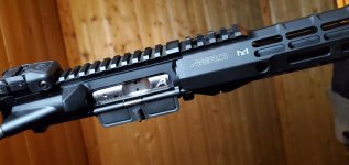

Speaking of gas blocks, I didn't even have to trim down my front sight any further, my new handguard has sufficient clearance.
