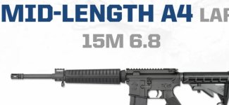

The type you seek is out there
The first photo is of a Rock River Arms gas block. The second photo shows Windham Weaponry pic rail with a bayonet lug on the left and one in the middle without a bayonet lug.
