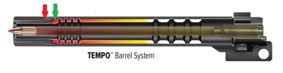

The 5.7 is gas operated. The barrel sits inside the "sleeve" and rotates to unlock. There's gas port near the muzzle end.
I don't have a 5.7 but I'd be concerned that shortening the barrel will reduce the distance from the gas port to the muzzle and *may* effect cycling.
The green arrow shows where the gas port is located. If you chop the threads off, you'd end up at the red arrow.

The 5.7 is gas operated...I don't have a 5.7 but I'd be concerned that shortening the barrel will reduce the distance from the gas port to the muzzle and *may* effect cycling.
That was my first concern too but a fellow forum member let this schwanging gunsmith gnaw the threads off their M&P 5.7 barrel and test it before I did it to my own. :)
My other concern was that since it’s a pistol, the chamber is part of the barrel length and with a 5.7x28mm being about 1.6” long, it already has only 3.4” of rifling. Taking the 0.6” of threads off the end puts it down to 2.8” and how’s that going to affect stabilization and velocity?
I need to bring the chrono along next time to compare unmodified and modified but it cycles just fine with the three different loads I tried in it; FN SS197SR and my 30gr Varmint Grenade and 55gr plinking reloads. It might be a little louder and the flash a little bigger but it's very difficult to see or feel the difference between the modified and unmodified barrels, and I really think the pistol looks a lot better without the threads sticking out.
