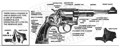

Per the schematic below, the main spring is in the grip and attached on one end to the hammer stirrup, and on the other end to the cutout in the front bottom of the grip frame, so that makes sense.
But this schematic doesn't show a "hammer spring". So I'm not sure which other spring you are referring to - unless you are suggesting I remove the actual hammer along with the mainspring. That seems like it would be removing too many of the moving parts of the action for an accurate diagnosis...

If you remove the hammer and mainspring, you eliminate the chance of breaking off the hammer pivot pin by cycling the action with the sideplate off. We are trying to determine if there is a hand and ratchet interface problem, so it won't matter if the hammer is out of the gun for that. I didn't say hammer spring anywhere that I can find.
OK, I'm following you now. I can try that. I'll et you know. Thanks
