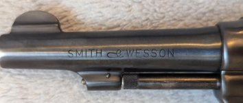

Finish looks original to my untrained eye, but is it typical for the wear on the side of that ejector rod to be more than anywhere else?

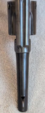

One item I cannot see in your photos is the top of the barrel. Do patent dates appear there? At C7080, I would anticipate their presence. They seem to show up as late as C8500, but they disappeared around that time.
As for the wear on the extractor rod, that is not at all unusual. It just means the extractor has been used a few times. I also seem to see a slight bit of holster wear at the muzzle. Again, no big deal. Overall this revolver appears to be in excellent condition and is certainly in collectible condition. I personally don't think $600 is out of line at all.
I will check.
No, there is nothing on the top of the barrel. Added that picture and more of the various markings.

That is one clean looking 38 M&P.
Yea now that I finally had a chance to take a close look at it, to my untrained eye it looks like this thing has barely ever been fired. Other than bit of holster wear at the tip of the barrel and a bit on the ejector rod, I see basically no wear. Looks new. She's real pretty for 76yo!
