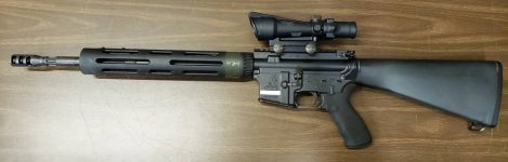

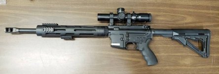

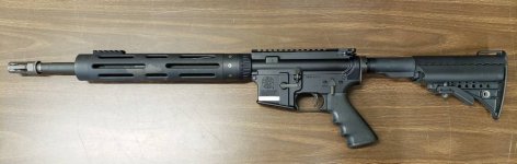

TT...just my thoughts. Not gonna get best performance w/long range optic on carry handle. Bore vs. height of carry handle. Couple o' pics...only S&W flat top no optic. Front sight never fired. Others JP's. One w/front site, flat top w/ACOG. See shadow of front. Last a JP w/1x8 Valdata lighted horseshoe dot reticle. Shot 3gun from Ft. Benning to Va. for 28 yrs til 2018. This is last one used in matches. Paper & steel. Hit 3" steel to 400yds. Bottom line is jf gonna shoot long range would suggest flat top upper. Lot on market. Anderson is good. Get stripped & use your internals. No serial# so no paperwork. All mine have free float tube which helps accuracy. If go to match, see what setups are used for distance. i learned by watching/talking with experienced shooters. Up close not so important but flat top & free float tube made difference distance wise. Again...just my experienced thoughts.20230510_212500.jpg20230510_212235.jpg20230510_212418.jpg20230510_212326.jpg

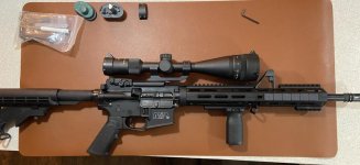

Wow! Very impressive! I’m new to AR platform. I started shooting & hunting small game when I was 12 with my Dad.( I’ll be 59 this year) I only have experience shooting iron sights with shotguns, revolvers and SA pistols, (as I was an LEO for 8 years before going to FD). I kinda put sport shooting on the back burner for a while until I moved down south about 9 years ago. I’m not familiar with some of the things you mentioned. I have much to learn. But I’m no competition shooter, nor am I interested in doing so. I just like to protect my family and myself and go to the range occasionally. I purchased this rifle at a pretty reasonable price, $539, I consider it my AR learning rifle. I have other home defense weapons that are much more readily available.
I started out with a 3X Prism scope on this rifle because I have Astigmatism and wear corrective glasses, so I had a hard time with red dots. And I couldn’t see targets very well past 50 yards with the 3X prism I had. So another person, on another forum, recommended this cheap scope as a starter. So far I can see pretty far with this 6x18x50mm SFP scope. It’s not mounted on a carry handle. Hers another photo. I don’t mind spending a little cash on this rifle, heck I got $1,200 in to a Kel Tec Sub2K 9mm PCC! But I’m in the learning phase when it comes to AR’s and optics! I’m also a sucker for good deals, so the only upgrades I’ve done is purchase stuff on sale, like a new Geissele 2 stage 4.5 lb trigger, the drop in handguard and the scope. I said I’m a sucker for a good deal but I’m cautious not to buy something of to low of a quality, I know you get what you pay for, right now I’m looking to just learn for when I buy or build my next AR. I’m just looking for an inexpensive solution to get rid of that front sight without just cutting it off, and have that gas block slot in my handguard filled up with a picatinny rail to match my current rail if possible.

TT...didn't see pic last nite. Misunderstood, thought was carry handle upper. Better understand settup after pic. Gave way to much info for your needs. Windham Weaponry (formally Bushmaster) has a clamp on picatinny rail gas block for .750 barrel. Measure barrel diameter to insure size. If so this oughta do it.
