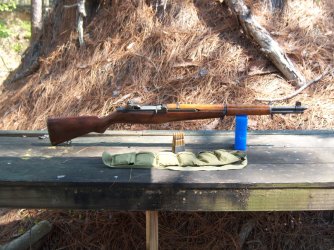

Cycling was perfect. No issues whatsoever and the bolt locked back/clip ejected like it should. Recoil was more than acceptable. I was standing, wearing a T-shirt and it didn’t beat me up. After getting the velocity, I had five rounds left. There was a bunch of cones and barrels on the range for the department training so I didn’t want to go back to 100 and shoot past them. I was able to find an angle at 50 yards for a clean shot. I fired five kneeling offhand into about 5 inches. Not my best work by far, but it grouped well and I’m assuming it’s capable of much better with me not sucking…..
Here she is with my ‘43 Remington Rand that I also shot today:

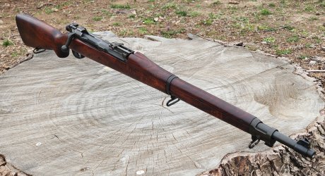

This is the ‘43 Winchester with the VAR barrel.

That VAR barrel is Danish if you weren't aware. I remember buying "Danish Returns" from the CMP North Store back in the early 2000's. If you can find any Danish made 30-06, buy it. Very accurate! I have a case or two that I am hoarding.
Yep, the Winchester is a Danish return. The VSR barrel is a ‘57. The only part that’s Winchester on the rifle is the receiver. Everything (other than the barrel) is Springfield. I also have a ‘43 Springfield with a ‘53 Springfield barrel. Everything is Springfield except the trigger guard, that’s Winchester. Go figure.

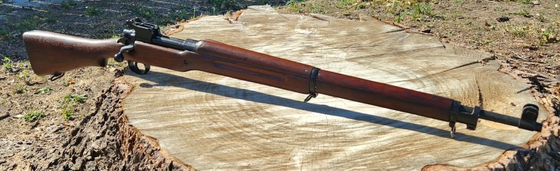

The Springer:
