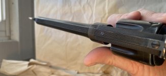

Hey guys,
I picked up the pistol yesterday. It’s a model 27-2 The barrel is marked “.44 S&W CTG.” and is not checkered like the top strap. The cylinder is recessed and the yoke has a different serial number than the rest of the pistol.
I’ve attached some photos. It is definitely a well-used firearm with considerable wear to the finish but seems solid mechanically. Let me know what you think about the cylinder/barrel as far as how the conversion was done.
Paul

Really neat gun!
Appears to be a period correct conversion. Meaning that (I’ll add I was a child at the time so really just repeating what others have stated) in the 60’s or 70’s Gun writer Skeeter Skelton and maybe others were very fond of the .44 special in the N frame. Outside of finding one of the .44 HE variations the next easiest way was to make one.
This helped spur the interest in converting m28’s into .44 spl. And obviously a 27 here and there too. Heck maybe even an RM out there was converted. lol.
And again if I have my facts straight…this prompted S&W to reintroduce the 24-3.
