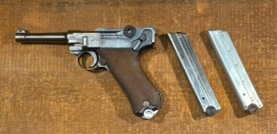

I bought an aftermarket magazine for my recently acquired P08
and it is one shy of original magazine capacity.
Is triple k better or worse than mec-gar?

The Stoeger branded magazine has maybe 95% feeding reliability. I would not bet my life on it working.
