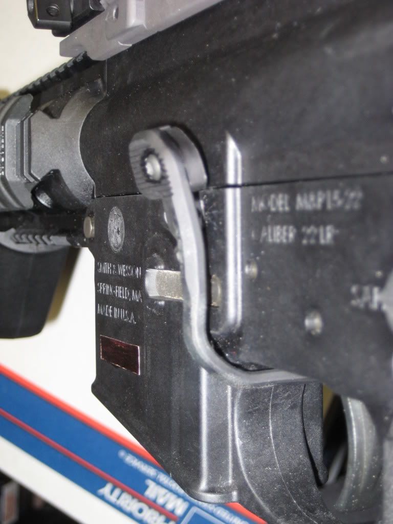

I have one on mine. Had to bend it slightly to the rear. Bolt works the same. Very fast for reloads. I use it for a 22 tact match. Works great.

The BAD can be adapted to the 15-22, it just needs to have the bend tweaked a bit.

you actually want to straighten it. I put it in a vise flat and slowly closed it(not installed). Kept doing it in small increments until it would clear the inside of the trigger guard. Not much is needed and I did not heat it up.

the reason the magpul BAD does not work out of the box for the 15-22 is that the bolt stop is about 3/8" further forward from the trigger than on the big AR.
the BAD can be made to work, but it involves four bends. these bends can be made cold, but it's a spooky experiance because the hardcoat finish audibly makes cracking sounds as it is being bent.
the first bend is the simplest...here you just straighten the BAD lever to make up for the 3/8" farther forward position of the 15-22 bolt stop paddle.
http://i241.photobucket.com/albums/ff271/texan610/rich/bend1.jpg
the second is to put a bend in the lever to clear the mag release when the bolt stop has the bolt captured to the rear. if you don't do this, when you punch the mag release, you will also trip the BAD so as to release the bolt. (this again is the result of the farther forward position of the 15-22 bolt stop)
http://i241.photobucket.com/albums/ff271/texan610/rich/bend2.jpg
the third bend is required to get the BAD lever back in closer to the receiver since bend no.2 makes it stick way out from the side of the rifle when it is not holding the bolt back. the start of this bend must begin below the lowest part of the magazine release and must be incorporated to work with the fourth and last bend.
http://i241.photobucket.com/albums/ff271/texan610/rich/bend3.jpg
the fourth bend is to get the tip of the BAD lever to the proper position for the tip of the trigger finger to operate the BAD.
http://i241.photobucket.com/albums/ff271/texan610/rich/bad3.jpg
the only thing left to do afterwards is to get some aluminum black and touch up all the stress cracks in the O.E.M. hardcoat finsh...or just paint it if you want.
work slow, try not to have to unbend anything you do bend...your results may vary...my first BAD modification took over an hour...

No personal experience on these but by looking at the Phase5 they look like a straight drop, unlike the magpuls that have the mild curve. The drop on the Phase5 will not line up with the 15-22. The magpuls work with a bit of bending because it comes down further out and then curves in. Eliminating the curve gives it the distance needed to work with the 15-22.
I just received my bad lever today and it took me literally 30 seconds to bend it. I wrapped the lever in a rag and used my table vice, it required only one bend. The anodize did not flake or crack.
The lever works flawlessly... the finished result looks identical to gcsniper's.
