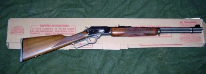

The Marlin 1894 rifles are nice. I have owned a couple in .44 mag. The one pictured is a late model, made just before Remington took over. It is well made, but not as nice as an earlier (1980's) blued example I used to own. I might look used, and avoid the Remington versions, as there has been a lot of complaints about their lack of quality control. I usually take internet complaining about guns with a grain of salt, but I have heard the recent Marlin complaints from too many people to ignore. The ones with "JM" stamped on the barrel are the pre-Rem versions.

On the marlin barrel it is marked REM (bad) or JM (good).
