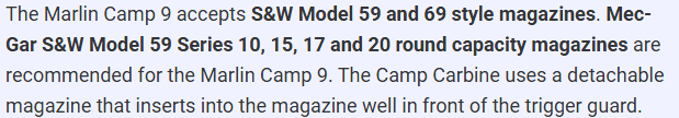

Marlin takes S&W mags.
Sounds like the Camp Carbine. I've got one that was formerly owned by the Oakland County Sheriff's Department (MI). They take S&W 59 series magazines.

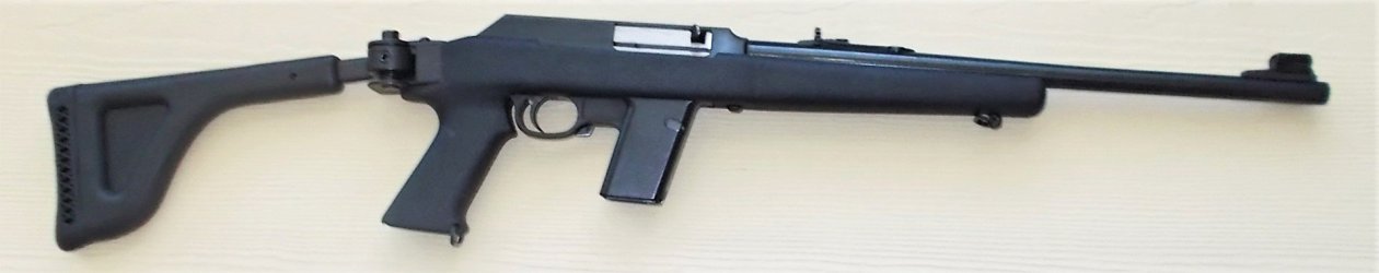

The Marlin made magazines are tough to find, so most everyone uses S&W Model 59 equivalents. Another thing to watch for is that the original hardwood stock is prone to cracking behind the receiver. I replaced mine with the Choate folding stock (they also make a telescoping M4-like version).

I have a .45 ACP version and it is fun. As mentioned the Choate folding stocks are good if you like a pistol grip stock. Also, if you like an optic sight, magnified or red dot, they are easily mounted. Personally, I have gone with a Williams receiver sight and am happy with that.

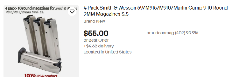

If you live in a state with restricted capacity or if you just want some extra 10 round magazines which do not hang down quite so far , they are cheap on ebay.

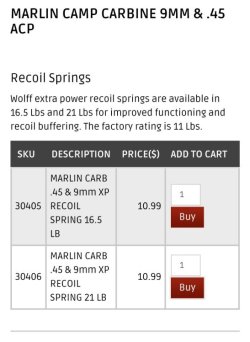

Don't forget to replace the recoil spring. Many folks advise using a stronger spring than stock.The factory spring was only 11 pounds. Wolff has replacements.

About those recoil springs. I've owned more than one Camp 9, and that 11# recoil spring seems pretty weak to me. Interesting l think, that the Camp .45 uses the same 11# spring, and same light weight bolt as the 9mm. Anyway, I have used the 21# recoil springs in my Camp 9s for years. Even with the heavy 21# spring, all of the many types of ammo I've used extracted and ejected normally. I mention this because many apparently think the 16.5# spring must be for the Camp 9, and the 21# spring must be for the Camp 45. The 11#, 16.5# and 21# springs all work in the 9s or .45s. But with the light bolts, and straight blow-back actions, 11# and 16.5# springs seem a bit light to me....YMMV
