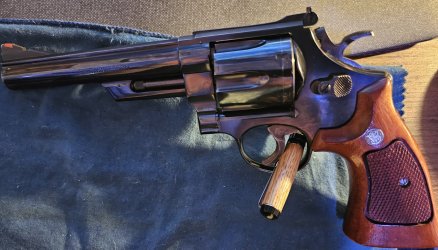

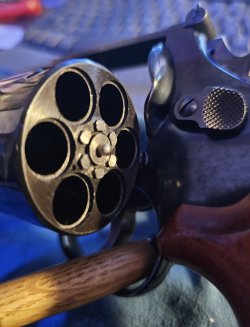

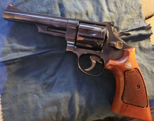

Here is a pic of mine... S# N801***. Pinned/Recessed, Triple-T, 6" barrel. As they stopped P/R in 1981, mine dates to late 1979 or early 1980 mfg. I searched everywhere for the "holy grail Dirty Harry 29-2" and this is pretty dang close. I call it the "Sudden Impact" model because I believe that was the only film to feature the 6" barrel and speed loader cut out goncalo alves stocks. I am waiting on S&W letter and will update with a fuller write up of this interesting piece of history.
Just so I'm understanding correctly... you have a 29-2 from 1979/80 that came from the factory with speed loader cut out stocks? I thought I had read that S&W didn't introduce the speed loader stocks until the 29-3 in 1981. The reason I ask is I too have a 29-2 6" from 1980 and I bought some speed loader replacements to my original "football" stocks, thinking they were still period correct. Then later, I read that the "football" style stocks were the only ones offered on the gun until the intro of the 29-3. If your speed loader stocks are original, this makes me happy!
