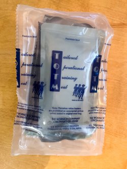

Here’s a small MRE I recently bought at the Base Commissary. It’s an actual Military item.
You might see the ‘same’ item for sale made by the same supplier, contract overrun, or just made more for Civil sales.IMG_2584.jpeg
Notice it’s Prop of US Gov.
No resale. (I have Gifted some)
No to Airlines? Heater Bag chemical reaction emits Hydrogen!
